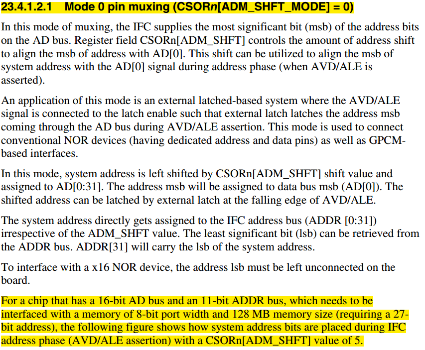

We have a custom board that has T1024 and a 128 MB x16 NOR Flash. In the Reference Manual, page 1084, it says that address shift value is 5. However, in the cfg_rcw_src field there is no option such 5, only 4, 7, 10 shift values are available. What value should I select for the cfg_rcw_src field?

It's stated in Rev. 0, page 1082

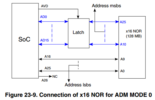

Yes, we use external latch.
In the reference design IFC_A29 and IFC_30 pins are used as address bits, but we use these pins as IFC_RB2 and IFC_RB3, because we have devices more than two on the IFC bus. So, we followed the reference manual while designing our board. Is there a way of booting CPU from NOR flash using the connections on the Reference Manual, Figure 23-9.
Please consider that the RM example has been given as a generic example. Not specific to this SoC. Just to explain the concept. The RM has the following note:
"NOTE
These figures are intended to be examples only and may show ADDR pins that are not supported."
In the specific case only IFC_A[16:27] are available for addressing purpose. In such case LSb of the system address will appear on A27. Shifting system address by 4 should work. ADM_SHFT should be 4.
No.

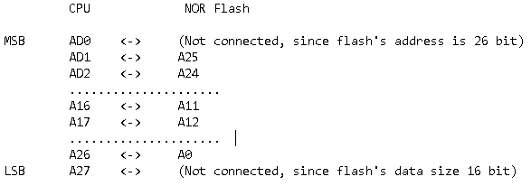

According to your mesages and reference manual, I assume that the connections for a 128 MB x16 NOR Flash should be like that
Is that right?
1,896 Views
ufedor
You are right.
