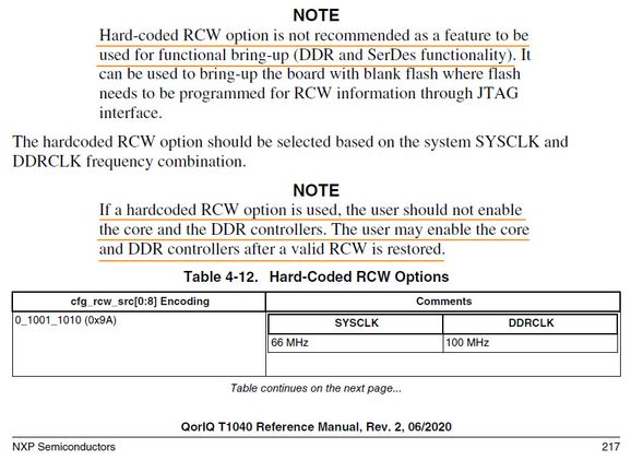

Hard coded RCW option cannot be used for the DDR validation:

Yes, but this is a working board where hardcoded RCW (from dipswitches) is copied to Flash at uboot and booting proceeds properly.

ufedor
For DDR validation please use non-hard-coded option containing a valid RCW.
