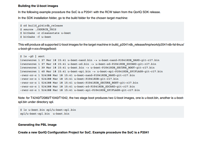

matiaslirman
Pavel,
I have been working on following the instructions found in the guide you provided but have gotten stuck.
It mentions the "SDK installation folder" and then specifies the necessary uboot files but I dont know where this folder or the files are. I have attached a screen shot to specify what I am regarding.
Also, I have downloaded the QCVS as specified by the documentation (I installed the packages on the already downloaded codewarrior for power architecture) but am unsure of how to get it started once installed. The guides online say to start a new QorlQ configuration project by choosing file >new> QorlQ configuration Project but that does not appear as an option for me (I am still in the codewarrior window). Is this another application that I cannot find? Any help with that would also be much appreciated. Again, thank you for your time and I look forward to your response.
