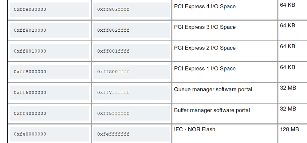

The memory map for NOR flash conflicts with BMAN and QMAN.
0xff6000000 0xff7ffffff Queue manager software portal 32 MB
0xff4000000 0xff5ffffff Buffer manager software portal 32 MB
Please refer to the following in include/configs/T104xRDB.h.

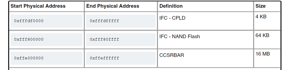

yipingwang
This is because the TLB entry for NOR flash is define as 256M page, 0xE8000000 is aligned to 0xE0000000.
SET_TLB_ENTRY(1, CONFIG_SYS_FLASH_BASE, CONFIG_SYS_FLASH_BASE_PHYS,
                      MAS3_SX|MAS3_SR, MAS2_W|MAS2_G,
                      0, 2, BOOKE_PAGESZ_256M, 1),
For your configuration NOR FLASH is defined as 0xF0000000 to 0xFFFFFFFF, this is conflicted with other devices, please refer to the memory map of the original u-boot.
