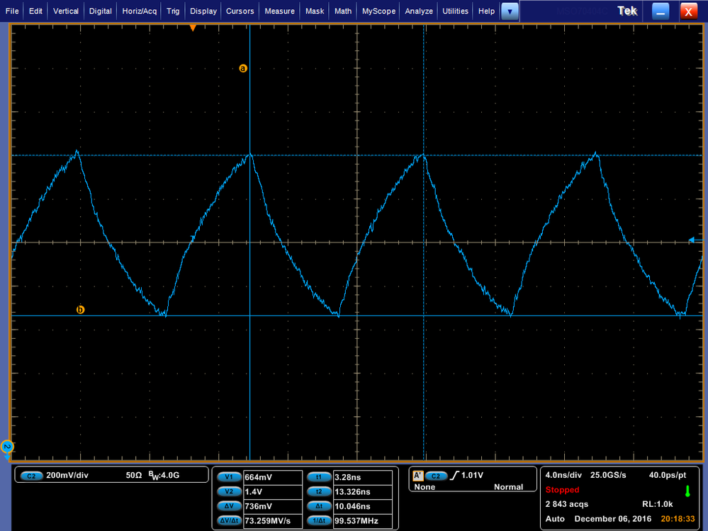

According to T1040 Family Datasheet, there is an internal 100-Ohm termination at DIFF_SYSCLK input.
In my custom T1040-based board I'm observing two rather different waveforms at DIFF_SYSCLK_P pin.
The first is for my default setup - SYSCLK is not used and pulled to ground:

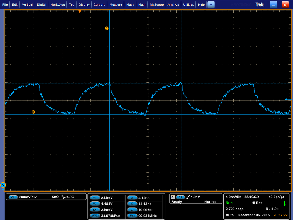

The second is for reworked board where both SYSCLK and DIFF_SYSCLK are connected to the clock source:
DIFF_SYSCLK was selected as the clock input to the chip in both cases. Clock source is CDCM6208 in LVDS mode.

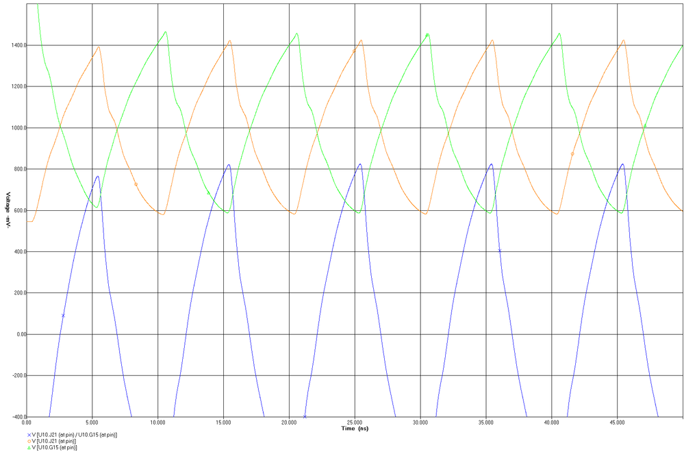

Next two pictures show DIFF_SYSCLK at T1040 pins (red/green - SE, blue - Diff) simulated with HyperLynx - unterminated at the CPU end:

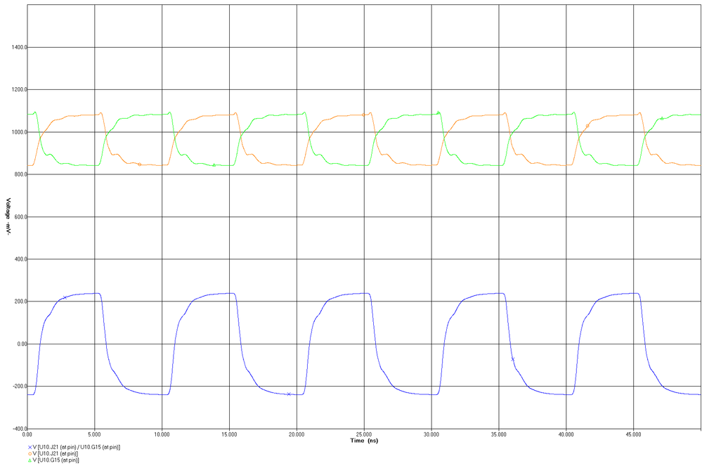

... and with internal 100-Ohm termination:
Please confirm that SYSCLK input must be connected to the clock source in order to enable internal termination at the DIFF_SYSCLK pins.
What another negative effects might be expected if SYSCLK is not connected?

Some hours of experimentation showed that the internal termination is activated if (and only if) all conditions are met:
  1) CPU is out of POR (i.e. PORESET_B is deasserted)  or  SYSCLK is applied; Обновлено
  2) cfg_eng_use0 is pulled down;
  3) cfg_eng_use1 and cfg_eng_use2 both pulled up (not down) at the moment of PORESET_B deassertion. Обновлено

These pins (cfg_eng_use) must be in a valid state not only at the moment of POR deassertion, but all the time during the PORESET_B assertion!
