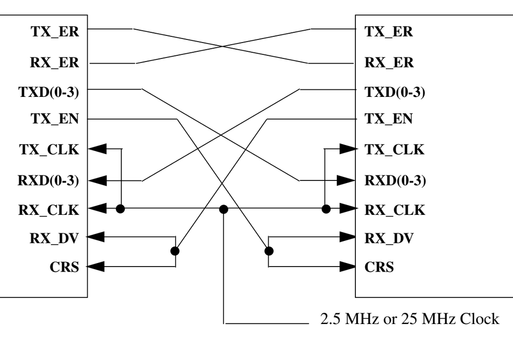

in my custom design, I want to have MII  to MII communication with T1022,
I have some questions about connection:
1) is MII-MII allowable connection in T1022?
 As i searched and understood, the connection should be as follows:
TXD[0:3] --- RXD[0:3]
RXD[0:3] --- TXD[0:3]
TX_EN --- RX_DV
 RX_DV ---TX_EN
RX_CLK and TX_CLK  must connect to External clock source.
2) how should connect TX_ER and CRS signals?
3) how many nanosecond should I delay between RX_CLK and TX_CLK?
Regars,
Roya
3,296 Views
r8070z
1) Yes T1022 has MII interface and you can connect MII to MII without phy. You can also read
PHY-Less Ethernet Implementation Using Freescale Power Architecture®Based Microprocessors
https://www.nxp.com/docs/en/supporting-information/WBNR_FTF10_NET_F0568.pdf
2) With a PHYless operation, it is necessary for the transmitting MII to indicate to the receiving MII that the frame is complete and that the data is valid (Rx_DV asserted). This is achieved by connecting the transmitting MII’s Tx_EN signal, which is asserted when the transmitter is sending a frame, to CRS and Rx_DV. MII-MII-niphy.png
3) The transmit and receive clocks (Tx_CLK and Rx_CLK respectively) should be driven from the same clock source to limit clock skew and provide correct synchronization between the transmitting and receiving devices.

roya_azimi93
Thanks for your response,
I confused about the answer of the third part.
As you noted, don't need delay between RX_CLK and TX_CLK .
But, in the attached document has been emphasized to delay between RX_CLK and TX_CLK because of receiver hold time.
please help me to resolve this issue.
Roya
