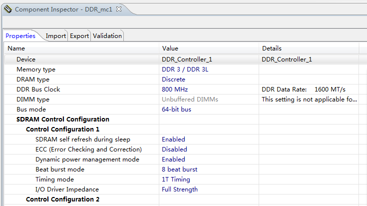

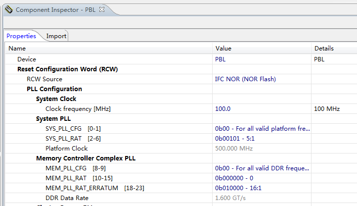

chuanfagao
MY T2081 board, we designed by ourselves;
I designed 1600MTS,but I measured only 400MHZ,I  think  it should be 800MHZ.
I do not know why?can somebody tell the reason?
thanx
