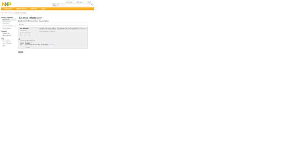

I have  purchased a dongle and ready to bind license. In the Product List, I choosed the license 6.3 CodeWarrior for Microcontrollers - Standard Edition to install (Is my choice correct? My computer is xin7_32bit). picture1

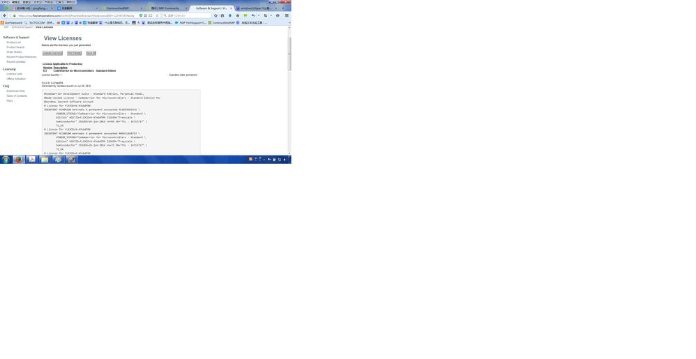

After I had installed license, I generated the license. picture2

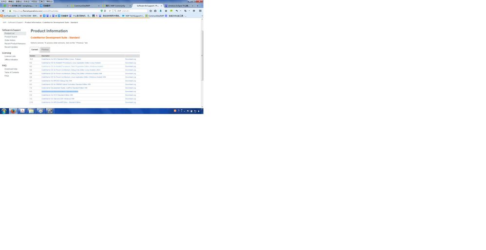

After I put in USB dongle and get the FLEX ID, Fill in the information on the page and generate license. picture3

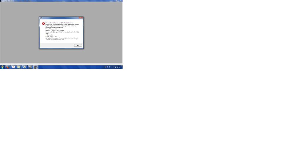

I click the 'Save All', and get license.dat file  picture4

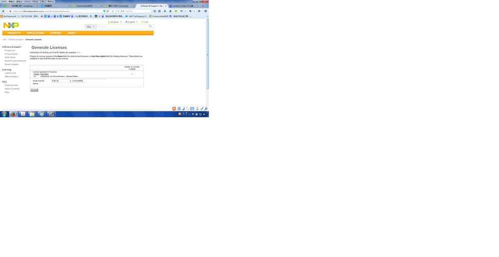

I put license.dat file to local disk, but can not open codewarrior picture5
How can I do that?

CodeWarrior for s08 v6.3 was released a while ago, some users have been experiencing issues using dongle on classic edtion. I will suggest to use Disk Serial as host instead of dongle for classic edition version that are no longer supported on win 7
-5 error means the license file is not being found. my suggestion is to use your disk serial license and test.
attaching a temp license file in case this also fails, if after this test you are still seeing this error create a case on support page , hope this helps.
