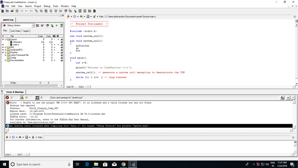

we have installed code warrior v8.8 for our MPC860 . And we are getting the following error upon project compilation.
Error : Unable to use the plugin "MW C/C++ PPC EABI". It is licensed and a valid license key was not found.
Feature has expired
Feature: Win32_Plugins_Comp_PPC
Expire date: 12-jan-2019
License path: C:\Program Files\Freescale\CodeWarrior PA V8.8\license.dat
FLEXlm error: -10,32
For further information, refer to the FLEXlm End User Manual,
available at "www.macrovision.com".
An unknown error occurred when compiling file "main.c" for target "Debug Version" for project "qwertt.mcp".
Kindly give your suggestion.

Seems the feature is missing does not belong to the license file you are using, you might need to add a different version to the license file in order to get the correct file.
create a case for www.nxp.com/support

Seems you need to generate the License certifcate that allows you to use the tool after trial period,  to do so , please follow the next video
https://www.nxp.com/video/how-to-register-and-activate-my-software:HOW-TO-REGISTER-SOFTWARE
