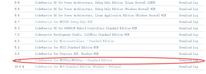

step 1: i download the "CodeWarrior for MPC55xx/MPC56xx - Standard Edition"from the web like the picture 1.

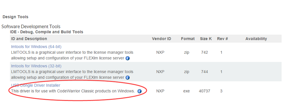

step3:i download the USB dongle drivers& lmtools for windows 32-bit from picture 2 .then installed the USB dongle Drivers .

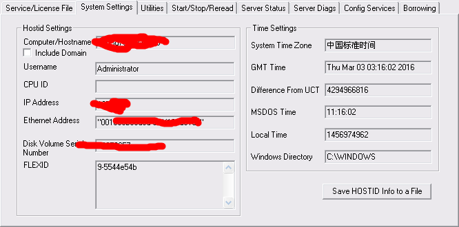

step 4:i run the lmtools and it showed that PC can read the USB dongle like picture 3.

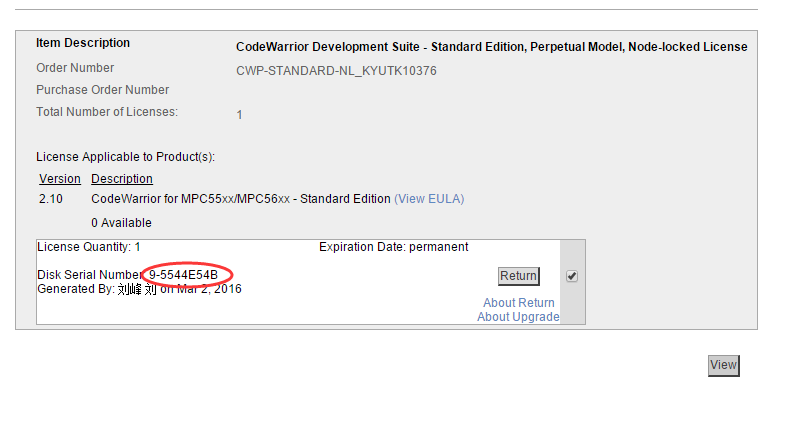

step5: i generate my license from the picture 4,and the key number matched my USB dongle.Then i place this new license to my installation root as C:/program files/Freescale/CW for MPC55xx/MPC56xx 2.10 and replace the old license file .

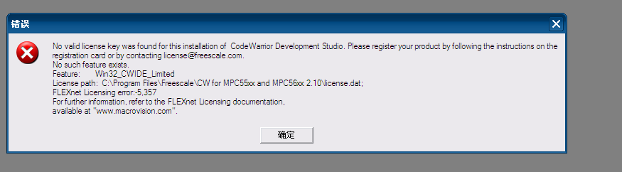

Step6: i plug my USB dongle in my PC and i start my CW for MPC55xx/MPC56xx 2.10 DIE, and a error message appears like picture 5.and with or without the USB dongle the same error appears.
NOTE:my windows edition is XP 32-bit.and i also tried on the windows 64-bit windows-32bit and windows 8.1-64bit  , always the same error.

We've a problem with the new web license generator.
In some case some keys (features) could be corrupted.
Probably this is the case for the IDE feature.
We need to correct and ren-encrypt the license file.
