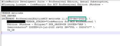

We have purchased codewarrior network license annual package 2 days back , and we generated the license.dat file and we placed into the CW 8.8 for MPC8248 processor, but  we don't know how to check the license expiration information in the IDE(Remaining days), please suggest us to find the info.

You will need to look at the License file it self it has an expiration date see example below:
