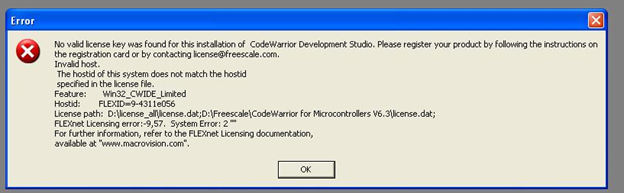

I tried to launch CW for MCU V6.3 and got an error:
You should get the same problem for HC12.

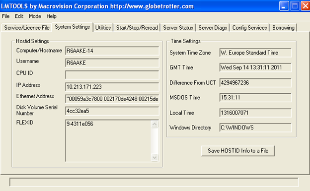

To check if the dongle is correctly installed you can download the lmtools.
Please install the tool version available on our web site via the link:
      http://www.freescale.com/webapp/sps/site/overview.jsp?nodeId=01521027262444119D11A5
Select the right file:
    lmtools for Windows (64-bit) or lmtools for Windows (32-bit)
Now I launched the LMTools and flexid is correctly displayed
Close the LMTOOLS.
Do you have the same on your side ?

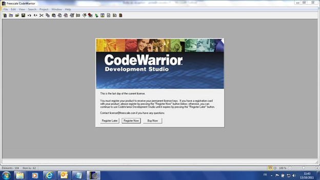

To check if the USBdongle license is working I recommend you to check the default USBdongle license file downloaded from the web.
When you will launch the IDE you will get a strange message saying it’s the last day of license file.
Do you have it ?
This message is introduced by an issue between flexlm driver used on CW for HC12 and USBdongle.
Every time, every day you will launch the IDE you will get this message … but the license will work.
So don’t care about it.
You can remove this error message if you add the key:
FEATURE Win32_CWIDE_Limited metrowks 5.5 permanent uncounted \
00E825C5615A HOSTID=ANY TS_OK
If you’ve this message, you can try to create a project and could see the build tool chain is working but not the debugger.

At the end, on the USBdongle, the red light should switch on.
Before to install the driver and plug the USBDongle - the first time, to avoid problem, I recommend you to switch-off your Network Connection.
