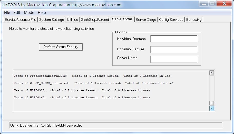

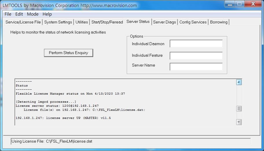

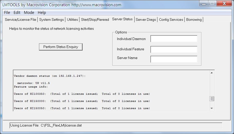

I had used an evaluation version of CodeWarrior® Development Studio for HCS12(X), I purchased a license of CWP-STANDARD-FL-ND a few days ago.
I conducted registration and generated a license key of Development Studio for HCS12(X).
And then I set up the license server environment.
(referring to "FLTLICINSTWINBR.pdf", at the client-side, I pasted "license.dat" from the server and set system variable)
Host and client PC are combined through a local network.
However, I got this message, when I try to compile.
At that time, the license server's status is like below.
