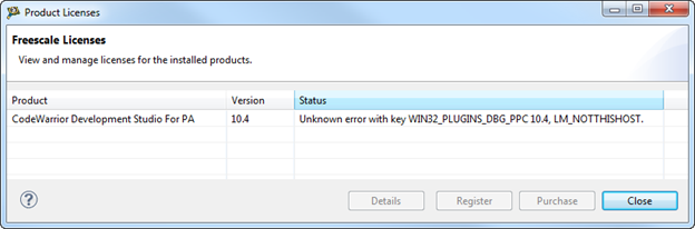

A- Description
Most of the time the “Product Licenses” is working fine but there are some cases where the information provided are wrong.
This is the case for:
  • USBdongle license file is used for NL,
  • Floating license file.
What’s about the USBdongle ?
Under PA V10.4 for instance when the USBDongle is plugged and the license file correctly installed when we launch Eclipse we get a license information:
According to the message there is a problem with the USBDongle or with the license file.
Most of the time the license file is running fine.
Is there a way to check it ?
                ……….. YES.

For the USBdongle, we can check the license file using an example project:
  • For MCU V10.6, we can launch the HC08compiler in standalone mode and try to build a big application (requiring a valid license).
  • For PA V10.4 we must use an application using Freescale tool chain (requiring a valid license).

CW for PA V10.4.
                Refer to the PA_full_test.avi attached
How can we test if an USBdongle license file is running ?
The best way is to create a project using Freescale compiler (GCC is free so more difficult).
For this test I will create a project based on 8250 device.
1st test: Without no license file.
2nd test: Add USBDongle license file in \CW_PA_v10.4.0\PA path.
However the USBdongle is not plugged on the PC.
So the license file is not running.
Re-start Eclipse and re-open same project.
3rd test: Same as 2nd test but I plugged the USBdongle key now.
Now the project is built without any license error even if the license information always provides wrong information.
