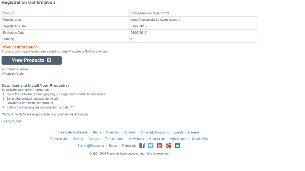

In order to renew your MQX RTOs add-on SW IPv6, DL-MQXIPV6-SR-PS
  1. 1.     Go to http://www.freescale.com/mqx/ipv6
  2. 2.     Select Buy/specification
  3. 3.     Click on Buy Direct for DL-MQXIPV6-PS-M Part ID
  4. 4.     Complete Buy Direct Process. order confirmation and e-mail will be sent with the Registration ID
  5. 5.     Go to www.Freescale.com/activation
  6. 6.     Enter your registration ID
  7. 7.     Select the Parent Registration/Entitlement ID to renew
  8. 8.     Check the Registration Confirmation and new expiration date.
Note: If you don’t have an active/expired DL-MQXIPV6-SR-PS, you will get an error message saying you currently do not have an active entitlement to the required software necessary to register this software product. Before purchasing make sure you have a valid registration/entitlement ID.
