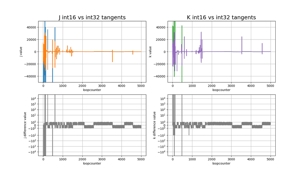

Here’s the issue: I was running some IMU+mag samples obtained from an LSM9DS1 sensor, which come as int16_t values. I calculated in parallel the tangents using those measurements, but I found that the values didn’t match. A big number of samples give tangent values that overflow the int16 capacity, resulting in an erroneous calculation on the tangents.
Moreover, the tangent calculation multiplied by 100 is, most of the times, orders of magnitude bigger than the values stored on the array used for indexing, the MagBuffer::tanarray
(-438, -207, -125, -79, -48, -22, 0, 22, 48, 79, 125, 207, 438)

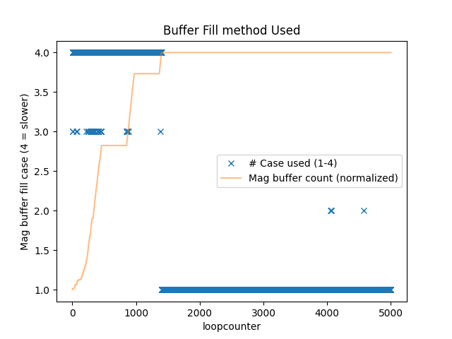

Well, after giving it a deeper look (and using a longer run) it seems like I need to correct some of my assumptions:
1. The buffer filling case #1 is more used:
Once the buffer is full the case the strategy switches completely. In this and previous runs the calibration values where added manually from a previous calibration, so the algorithm starts with `fV`, `finvW`, `fB`, `iValidMagCal`, etc already set.
2.  The non overflowed (int32_t) tan values are just in some counted occasions much bigger than the overflowed ones.
But still: if someone can explain a little further why this method works I would really appreciate it.
