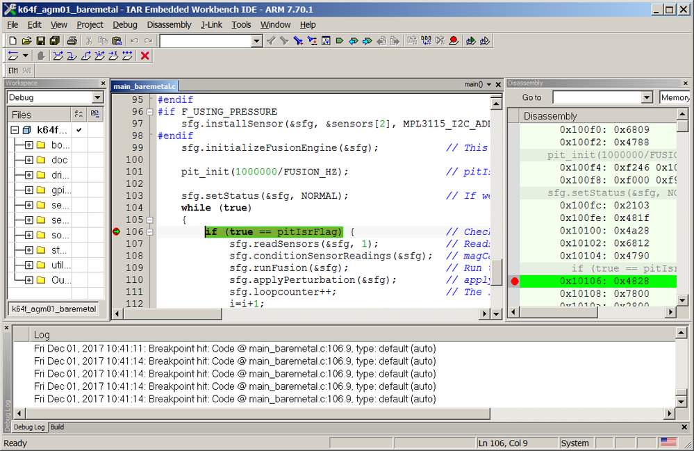

I just purchased a K64F-AGM01 assembly. Never used the NXP products before. I'm stuck. I've searched the community for hours and hours for answers. Read every documentation I could find. Still can't seem to find the information that I need to build my project.
I loaded a SDK example for sensor fusion. Ran the example in debugger, but it runs through the cycle once, and since pitIsrFlag doesn't == true on the first pass, the program ends. I get no data from the sensor fusion functions. Am I supposed to write my own program to call the bare metal main function from a loop I create separately?
8 返答(返信)
3,730件の閲覧回数
michaelestanley
Randy,
Let me ask, are you trying to single step through the debugger?  If you try that on the
if (true == pitIsrFlag) {
statement, you will go nowhere fast.
The reason is that the PIT timer is programmed to "freeze" in debug mode.  From the PIT chapter of the K64 Reference Manual:
The good news is that you can put a break at the next line after the IF, RUN to that point, then continue single stepping.
Does your board flash green on LED D12 on the K64 when you just power it up outside the debugger?  If so, the app is running fine and this is just a pilot error.
The other thing you should do is startup the sensor fusion toolbox and connect to the board.  That will enable you to see it operating correctly.
Mike
