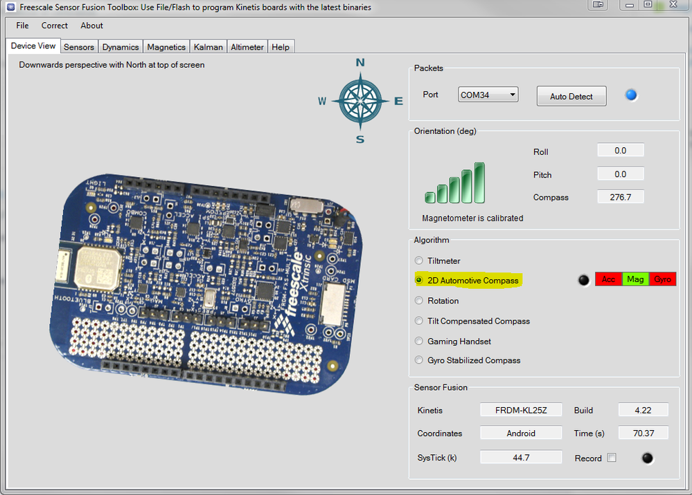

              When I was in debugging mag3110, because our equipment is the on-board equipment, calibration, so unable to manually draw a figure 8 so I want to seek advice, is there any other method of calibration.

                our  equipment  was installed int the car,  so it can't to draw 8 to calibration.   I know a  circle algorithm,  can you introduced to me?   and  send  the circle algorithm code to me?

You can have a look at the NXP Sensor Fusion​, we provide a full and open source project for electronic compass.
As the application is embedded in a car, you can NOT run the full 3D compass because you have 2 axis only.
The Sensor Fusion provides different algorithms for electronic compasses and IMUs. In your case, you can use the 2D Automotive Compass which needs a 2D calibration: instead of drawing a 8 it takes only a circle as you mentioned.
Code samples are available on our website.
You have to check the
void fRun_3DOF_B_BASIC(struct SV_3DOF_B_BASIC *pthisSV, struct MagSensor *pthisMag, int32 loopcounter, int16 ithisCoordSystem)
function in the fusion.c file.
Anthony

If you want to understand the algorithm, I attached a document about magnetic calibration.
The algorithm is based on an ellipsoid (ellipse in 2D) recognition. When the ellipsoid parameters have been extracted, the algorithm transforms the scattershot  into a sphere (circle in 2D) with mathematical operations.
