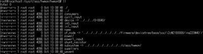

I used the ina220 current monitor by referring to the ls1046frwy document.
http://www1.futureelectronics.com/doc/NXP/FRWY-LS1046A-TP.pdf
The ina220 current monitor result value is different from what I expected, so I want to modify the ina2xx.c code. According to the QorIQ LS1046A BSP v0.4 document, the source code location is drivers/hwmon/ina2xx.c, but hwmon is not visible in /sys/bus/i2c/drivers. I found hwmon in /sys/class, but when I entered hwmon0 inside, I couldn't find ina2xx.c. I would like to know where I can find ina2xx.c.

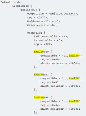

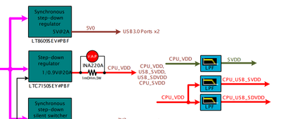

Additionally, there is a problem that a total of 3 ina220s are used, but only 1 is captured. Is it correct to put the i2c address in channel@2 of the default node in ina2xx.c as shown in the picture below? Also, it would be nice if you could tell me where to modify the calibration register.

Please enable the following options in Linux Kernel configuration file and rebuild Linux Kernel. It seems that these options are not enabled by default.
CONFIG_I2C_MPC=y
SENSORS_INA2XX=y
In the dts configuration, reg is I2C address of the device.
ina220@44 {
compatible = "ti,ina220";
reg = <0x44>;
shunt-resistor = <1000>;
