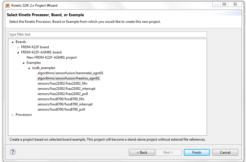

I believe I have accomplished this. When I do so I'm presented with the following menus:
Is this what you were referring to when you recommended the following:
Try the application under SDK_2.1_FRDM-K22F/boards/frdmk22f_agm01/issdk_examples/algorithms/sensorfusion
If not, where is the recommended application?

1,525 Views
michaelestanley
Lucas,
Either of the 1st two listed will work.  algorithms/sensorfusion/baremetal_agm01 does not require an RTOS.  The freertos_agm01 version is based on FreeRTOS.  Just open them up, compile and download to your board.  Then fire up the Sensor Fusion Toolbox and click the AutoDetect button.
I also HIGHLY recommend you read the documentation for the sensor fusion kit.  It's in <sdk_root>/middleware/issdk_1.1/algorithms/sensorfusion/docs.  Start with the datasheet (NSFK_DS.pdf) and then move on to the user guide (NSFK_Prod_UG.pdf).

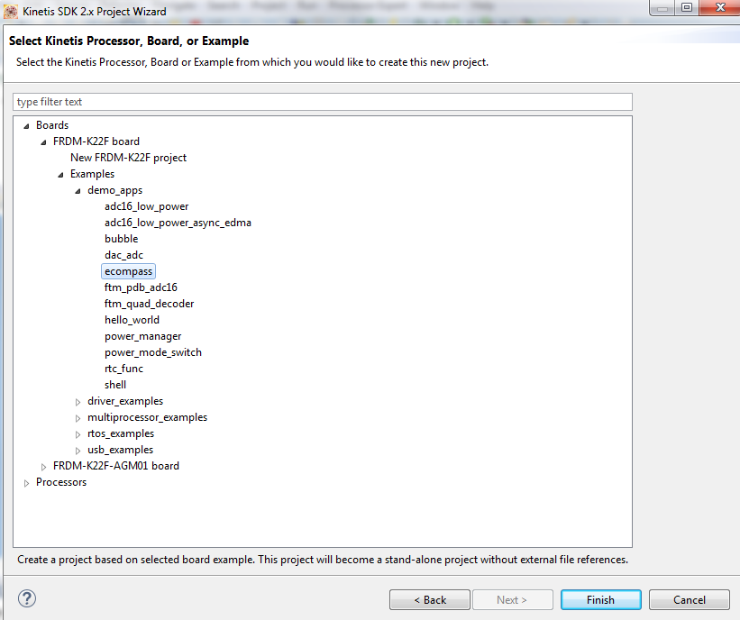

Here is the workflow I followed:
I went to: Welcome to MCUXpresso | MCUXpresso Config Tools and created an SDK for my hardware platform (FRDM-K22F-AGM01).
Download SDK
Unzip SDK
Open Kinetis Design Studio
File->New->Kinetis SDK 2.x Project
Navigate to the SDK downloaded from the link listed above
Name Project, Hit Next
Go through nested menus as follows: Boards->FRDM-K22F board->Examples->demo_apps->ecompass
Here is a picture:
Click Finish
From here I have a full source code project I can work with in Kinetis Design Studio. This project builds fine and I have edited it successfully, adding some debug statements, button pushes, etc. I have not touched any of the ecompass code. The fact that I am able to build, load and debug the program on the target hardware makes me feel like I didn't miss any check boxes or fat finger something anywhere in the download process. As far as the project goes the magnetic calibration is built in, and once complete the program repeatedly prints the ecompass reading over a COM port to a putty window.

michaelestanley
Thanks Lucas, I found it.  This example was up to date maybe 8 years ago, but we've gotten much better since.  I need to see if I can get this one removed from the SDK.  It is not based on the sensor fusion library, and a quick inspection of the code shows it's offers only a 1st order hard iron computation.  I suggest you switch to the examples I pointed you to above.  They provide not only basic eCompass, but a full 9-axis version that is far superior.
Mike
