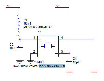

hi NXP,
i have some doute for part selection for TPMS system as follows:
1) at how much PPM 26 MHz crystal we can used ? any documentation if we have please share me.
369 Views
JozefKozon
Hi Pranav,
for the recommended Crystal, please refer to the schematic of our EVB attached. EXS00A-CS07225 is used.

Pranav_Tonape
hi Stephen baker,
thanks for replying me, based on your answer i have following query:
1) what is the maximum frequency tolerance is acceptable for NTM88?
2) and if i increase the frequency tolerance what would be the effect we will obvers with NTM88 application and performance wise while other parameter is keeping same?
3) what is the maximum Load capacitance is acceptable for NTM88?
4) and if i increase the Load capacitance what would be the effect we will obvers with NTM88 application and performance wise other parameter is keeping same?
5) what is the maximum Equivalent series resistance is acceptable for NTM88 ?
6) and if i increase the Equivalent series resistance what would be the effect we will obvers with NTM88 application and performance wise other parameter is keeping same?
