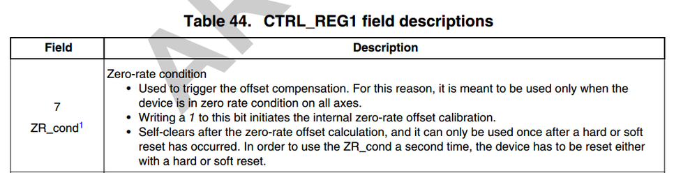

Hi. I am using FXAS2100X with Accelerometer and magnetic sensor to get a roll, pitch, yaw.
and I want to decrease gyro sensor drift error as much as i can.
Question :
I found that FXAS2100X(gyro) has resister to initiate drift offset. and if i use this register periodically, can i reduce a offset error slightly??
2,935 Views
markpedley
This feature simply makes a measurement of the gyro rate and then subtracts it off from future measurements. Of course, you have to be absolutely sure that the gyro is not rotating when this feature is used. From a user interface viewpoint, users may not like the extra step of ensuring the unit is stationary and then pressing a button.
It also doesn't fundamentally solve the problem of gyro integration over long periods of time. The gyro offset is temperature, orientation and acceleration dependent and software integration errors will also add up over time. So you'll still need to use a Kalman or other filter to stabilize the orientation to the gravity and geomagnetic vectors.

A balance must be found between power on estimation of the gyro offset and tracking of the gyro offset drift over time.
One solution would be to ask the end user to place the PCB stationary and then use that value to estimate the gyro offset.
And then the gyro offset could be saved to non-volatile memory and then read on power up.
