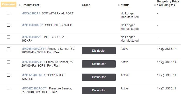

Revisiting a board design from several years ago which used MPXA6400A pressure sensor, in the 1369-01 case.  It's discontinued, as is the "super small" MPXHZ6400A.  It looks like only the MPXH6400A is available nowadays, however its overall height is problematic.  The 20-400 kPa range is definitely a requirement for us.

Hello Steve,
The possible replacements are any in that product family which are not EOL.
Tomas

Thanks ... except how can MPXHX6400A6T1 be simultaneously ACTIVE and DISCONTINUED 2 YEARS AGO ? A question for NXP's website
manager, I suppose. Available stock of this version is 0 at Mouser/Digikey, so I think only the 98ARH99089A pkg drawing ("AC6T1") suffix is an option.
