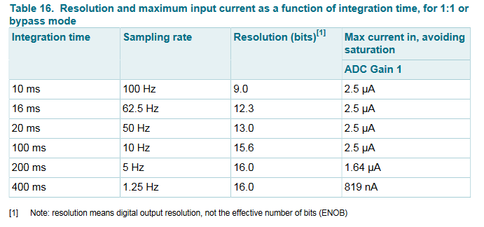

I want to read a real-time signal by NHS3152 NFC chip, through the current-to-digital converter.
What is the time resolution (from one data point to the next data point.. maybe the sampling rate?) of the chip?
I expect to measure body signals with a time resolution of sub-millisecond.

Hi Young-Geun,
I think you are referring to the sample rate/integration time, which is supported from 10ms to 400ms. Please refer to the following for more details.
