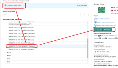

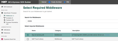

looking at the IoT Sensing Software Development Kit (ISSDK): Embedded Software Framework page, it seems that Sensor Fusion library is part of ISSDK now. It also states that it is available for i.MX platform. So as you advised I selected ISSDK as in the middleware filter on the SDK builder site. After that I was able to go to the boards selection.
Then I selected MIMXRT1170-EVKB board with ISSDK filer enabled and built SDK version 2.15.100:

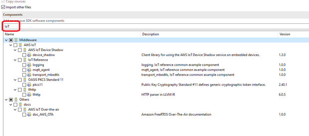

Next I imported the SDK I built to the MCUXpresso.
The problem is I don't see any ISSDK or IoT sensor-related components I selected to include to the SDK in the list of the SDK Components, all you see below is something else:
So how can I get the ISSDK for MIMXRT1170-EVKB?
