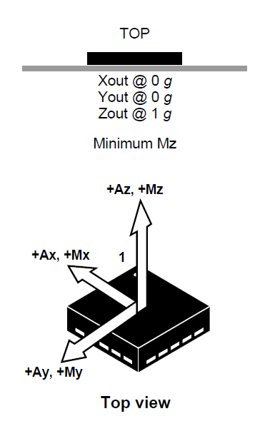

You can take a look at our Application Note AN5017 (more specifically paragraph 1.4 and 1.5) to have a better understanding.
To give a simple example, let's assume you are using the Aerospace / NED standard. If the accelerometer is mounted horizontally in your end product, it will measure +1g as stated in FXOS8700 datasheet (cf crop of fig.4 below), at least when the product will be layed down horizontally.
The earth gravity vector is oriented downward, hence aligned to Z-"Down" axis of the NED XYZ-reference frame. Consequently the Zout = +1g accelerometer reading will also apply directly to the NED frame.
If the sensor was mounted upside down in the end product (e.g. located on the bottom side of the PCB), you would need to negate the accelerometer data to match the NED frame convention: Zout = -1g for sensor but Z = +1g in the NED frame (unchanged for the end product).
Practically, when the sensor and NED axes are in opposite direction, you can use the sensor data as is, whereas when they are in the same direction, you shall negate the sensor data with the appropriate HAL matrix. This matrix will also handle axes permutation if any.
