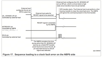

   I need to use pressure sensor NBP8,  but when I try to operate it by spi, I meet some problems
   when I need external host  waking up the NBP8 ,should I pull up  CS_B/WAKE_UP pin then pull down it again after READY/INT pin pull up? if I do it , the response for NBP8 is always 0x1002.
   if I don't pull up and pull down CS_B/WAKE_UP pin ,when I try to operate register by spi , the response is always 0x2002.
   can you tell me how to solve it ?

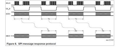

    I find a solution ,before I transfer a command(2 bytes) , I need to pull up and pull down the CS_B pin, then I can get the correct response.  I follow the sequence shown in the image below
    I wonder whether I can transfer many commands without pulling up and pulling down the CS_B pin?

Hi Cao,
please share a scope of the SPI signal when you try communicate with the NBP8. The CS_B pin must be low, when you want to wake up the NBP8 or you want to communicate with.

I have a same problem with you,
if I pull up CS_B/WAKE_UP pin then pull down it again after READY/INT pin pull up, the response for NBP8 is always 0x1002. If not, I always get 0x2002.
The following is my code
