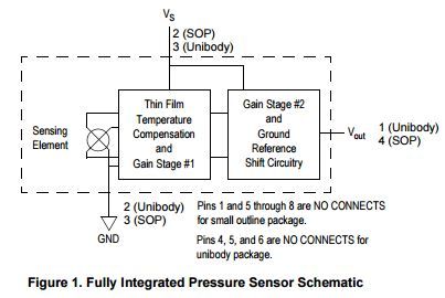

MPX5010DP and MPXV5010GC7U Datasheet does not give precise info on power & signal pins for packages 482C-03 and 867C-05for MPX  pressure sensor . Please let us know.

Hi Manoj,
MPX5010DP (Case 867C-05, Unibody Package):
1 – Vout
2 – GND
3 – Vs
4 – N/C
5 – N/C
6 – N/C
MPXV5010GC7U (Case 482C-03, Small Outline Package):
1 – N/C
2 – Vs
3 – GND
4 – Vout
5 – N/C
6 – N/C
7 – N/C
8 – N/C
Tomas

Mr. Tomas,
Thanks for your prompt assistance. And it has solved our major issues.
One minor query: When checked with multimeter, we see about 700 ohm
resistance between Vs and GND, . Hope these values are O.K and we can
safely apply Vs to the sensor.
Thanks again
