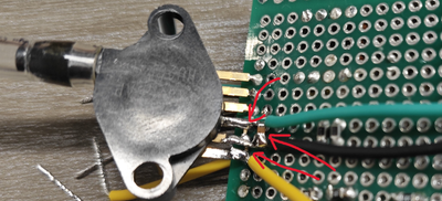

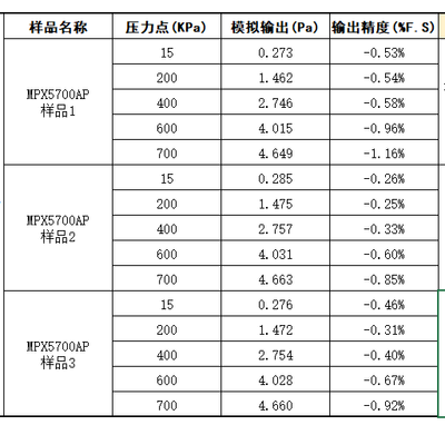

I am not sure if the accuracy of my MPX5700AP meets the standards, and if there are any better suggestions for my testing circuit (has my current circuit had a negative impact on my testing
accuracy?) .I have connected the necessary capacitors as required.
Thank you very much for answering my question.

规格书是有些精度的,你的测试最好在PCB板子上测。

您好,我就是想问产品输出误差,规格书上没有写,以及使用方法是否需要改进。公司的确有部分压力传感器产品,
2,116 次查看
chaoyueff
好的,样品我会移到PCB板子上测。感谢您的答复。
