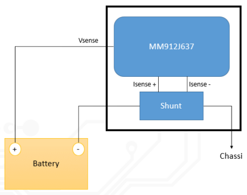

marinadioto
This is my setup:
2,252 Views
Q_man
Marina, is the Chassis side floating? How does the current reading look like if you short Chassis to Battery Minus?

TomasVaverka
I am just adding here Wolfgang’s answer to keep this thread consistent:
Depending on your setup you should see either ~0mA or ~35mA (typical current consumption of the board - no balancing, no additional loads).
Items to check:
  • in your setup is the current consumption of the board measured (flowing accross the shunt)
  • measure the acctual current consumption of the board
  • have you used the calibration values provided on the back of the shunt (sticker)
The Ah counter basically sums up all CSENSE measurements: AHC = SUM(CURR).
I expect in your setup the CSENSE is continuous running at 1KHz data rate. Which for 1 minute would be 60000 samples which are accumulated. So the average current Iaverage = SUM(CURR) / number_of_samples = 7690884/60000 = 128mA
Tomas

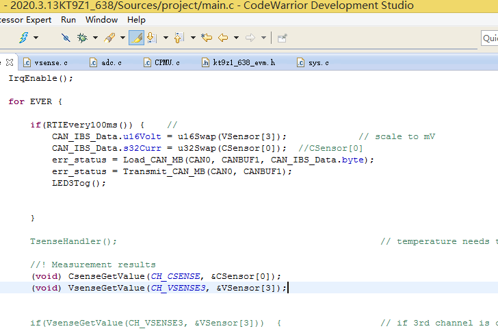

964839564
HI ,
i use my board  to measure voltage and current,but its value are increase all the time.Is there something wrong with my schematic or my program(KT9Z1_638_CAN_demo).Design1.PNG
Thank you.
H YW

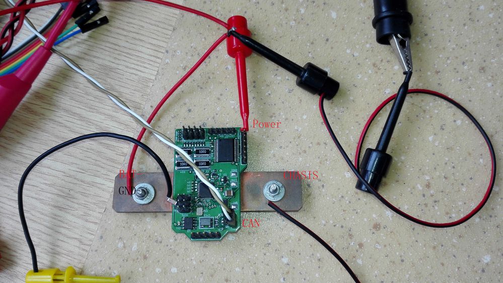

bigoblue
  • the current flowing accross the shunt(100uΩ​)
  • I want to measure the acctual current consumption of the board (no additional loads)
  • I used it.
  • connection.jpgwhen my Power GND connect to the CHASIS the current register was read as 0xFFFF94. when my Power GND connect to the BAT- the current register was read as 0xFFFF76(the result is always changing).The number of 0xFFFF94 is right,is it related to the hardware?
  • Thanks for the answer of Ah counter.
2,252 Views
Q_man
You state that the 0xFFFF94 is right, why?
You measured:
  • 0xFFFF94 (is -106 mA) in the Power Supply GND -------  BAT- terminal   (Ishunt = Iload)
  • 0xFFFF76 (is -136 mA) in the Power Suply GND ------> CHASSIS terminal (Ishunt = Iload - Isup)
With Iload = 0A, we can see that the Isup is about 30 mA (delta between both) and that we have a offset error of ~100mA. What values did you have on the Shunt sticker?
Did you measure Isup with an ext. Multimeter?
