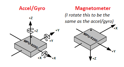

I am developing an application that uses  a 9-DOF MEMS navigation device (InvenSense MPU-9250, hopefully containing NXP parts??) to provide real-time orientation on custom designed hardware, software and drivers. Since everything is custom, I had to strip down the SensorFusion 7.0 library to the core routines provided in the SDK. In addition, I call the initialization functions directly and wrote my own function to load the data into a 1 element FIFO for gyro, magnetometer and accelerometer.
The axes of the MPU-9250 are defined as shown in the image below. Therefore, I rotate the magnetometer axes to make it the same as for the gyro and accelerometer. I do this by negating the Z-axis and swapping X and Y axes.
I have also checked to confirm that the units are correct (acceleration in g, rotational velocity in degrees/s, and magnetometer in micro Teslas). I set the conversion factors for "counts per unit" and "units per count" for integer and floats appropriately (or so I believe).
I am running the fRun_9DOF_GBY_KALMAN algorithm at 200 Hz and loading new data/samples into my 1 element FIFO also at 200 Hz for all 9 axes. I find that after moving the device around a bit, the iFirstAccelMagLock flag will switch from 0 to 1 (which would seem to be a good sign).

  1. Where is it specified exactly what the expected input axes and units are for all 9 degrees of freedom, including rotational direction for the gyro? I assume that X, Y and Z axes should all be consistent for gyro, mag and accel, and that the right hand rule should be satisfied for the gyro rotational direction. But again, is this documented precisely somewhere?

Jonathan,
We don't normally offer support for ports on competitive parts (Invensense is NXP's competition), but I'll try to answer a few of your questions (and others are welcome to jump in with additional suggestions).  In order:
1.  Section 5.3 of the user guide discusses hardware abstraction issues.
2. The Kalman filter includes gyro offsets as 3 of the variables (XY&Z) it tracks.  So long as your device has some rotation, it will continuously update those estimates.  The magnetometer and gyro reference vectors should keep things stable when the device is at rest.
3. Sorry, I can't offer code reviews.
4. Proper magnetic calibration is very important.  Don't expect good 9-axis results without it.  The routines we include generally do a pretty good job handling hard/soft iron sources that are fixed spatially with respect to the sensor.  We include some code to handle general interference, although there are limitations to just how well that can be done.
5. If you check the code comments, you will see that  iFirstAccelMagLock is just a boolean variable used to ensure that some initialization code runs only once.  Don't infer any general health from it's status.
6. I see no problem with the approach you outline so long as your MCU has enough MIPS to keep up.
7. Read the manual.  I tried to put as much "collective wisdom" there as I possibly could.
Mike
