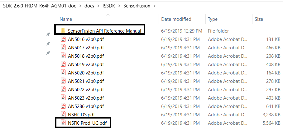

Is there a section in the User Guide or another .pdf that gives me pointers on how to port the Sensor Fusion Library to other boards?
2,962 Views
AmitPurohit
Hello Quy Nguyen,

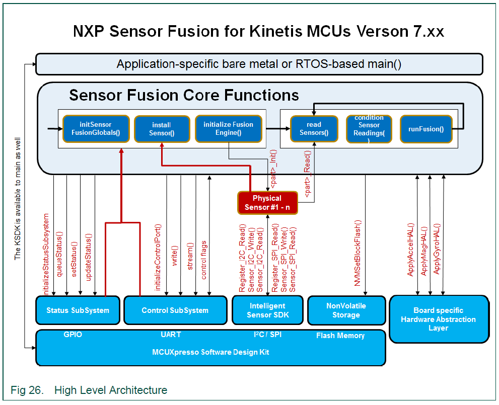

There is no porting guide available for sensor fusion library. But there is a user guide available for sensor fusion that provides high level architecture as part of section#4 (providing snapshot below). Also it provides details of various sub-systems and functions along with data structures.

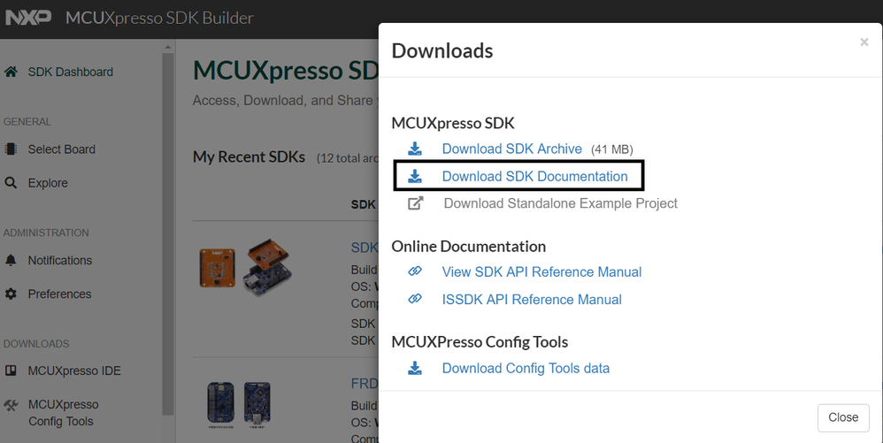

You can refer to available sensor fusion library documents (user guide, API reference manual etc) by downloading supported sensor kits SDK from https://mcuxpresso.nxp.com. Providing below a snapshot of SDK documentation for FRDM-K64F-AGM01 kit where you can find sensor fusion library documentation:
