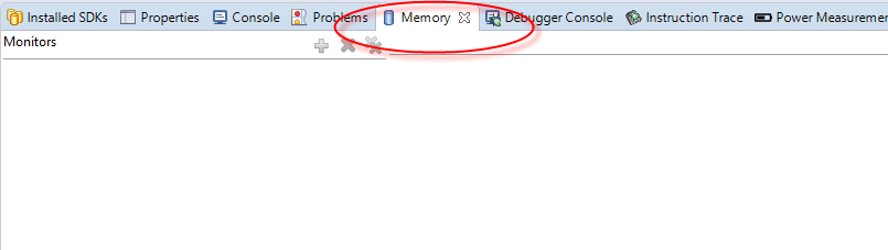

Is there any way I could read the flash contents in command line ? GUI flasher tool in IDE dont have flash read back option. Basically I need to know the image I am writing is loading at correct location

Kan_Li
I think the memory viewer can be used for that purpose during debug.
Kan
