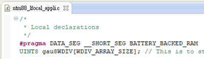

To store a few bytes of data from one wake up to another, it is recommended to use the parameter register section of the NTM88. This section is similar to RAM but maintained in STOP1. It is 64-byte long. If more than 64 bytes need to be stored then writing in flash can then be used.
In the GenFSK Beacons project, gau8WDIV array is stored in the parameter registers, so the value is maintained in STOP1:

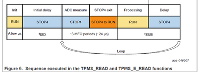

Have you considered using the TPMS_READ or TPMS_E_READ functions?
When the functions TPMS_READ or TPMS_E_READ are executed to read raw pressure or acceleration measurement, the sequence detailed in Figure 6 is executed.
Please review the file attached this response. I do recommend using it as a reference for your design.

Reading flash memory can be done directly by the application, there is no need for a library function.
For example, below instructions read address 0xE000:
                      add = 0xE000;
                     u8Read = *((UINT8*)(add));
More information can be found in the user manual and in the document “NTM88_RAM_and_FLASH_Organization” that can be found in the folder documentation > doc_ntm88 of the Starter Package.
