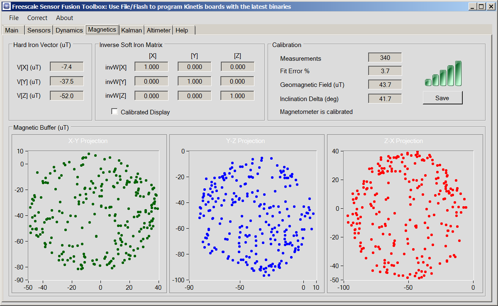

What does the "magnetic" tab display in the sensor fusion toolbox look like?  Here's one I just captured with my K64F/MULT2-B board combination.
You can use File->Reset to clear the magnetic buffer.  Then rotate the board in as many orientations as you can over a minute or so.  There are actually THREE different magnetic calibation options built into the library.
  • The four element solver determines field strength and hard iron vector.  The inverse soft iron matrix is set to the identity matrix.  This is the simplest solver, and is consistent with what you see above.
  • The 7 element solver adds non-unity diagonal elements to the inverse soft iron matrix.
  • The 10 element solver adds off-diagonal non-zero elements to the inverse soft iron matrix.
The "magnetic calibration" functions start out with the 4 element solver at power up.  When some level of fit is accomplished, it will try the 7 element solver.  If the 7-element does a better job, it will switch to that.  Then it tries the 10 element solver.
In a magnetically perfect environment, you should see circular patterns (like those above) for the X-Y, Y-Z and Z-X figures above.  Hard iron offsets are normal and expected.  If you have some ferrous materials in your device, you will see ellipses in one or more of the above.  If you click the "Calibrated Display" checkbox, you can see how the algorithm maps the raw measurements into calibrated data.
Often this display,  possibly coupled with the "Sensors" tab, will give you the information necessary to diagnose a problem.   I like the "Magnetics" tab, because I can watch how new values map to the ideal sphere in real time.  So move your board around and see what happens.

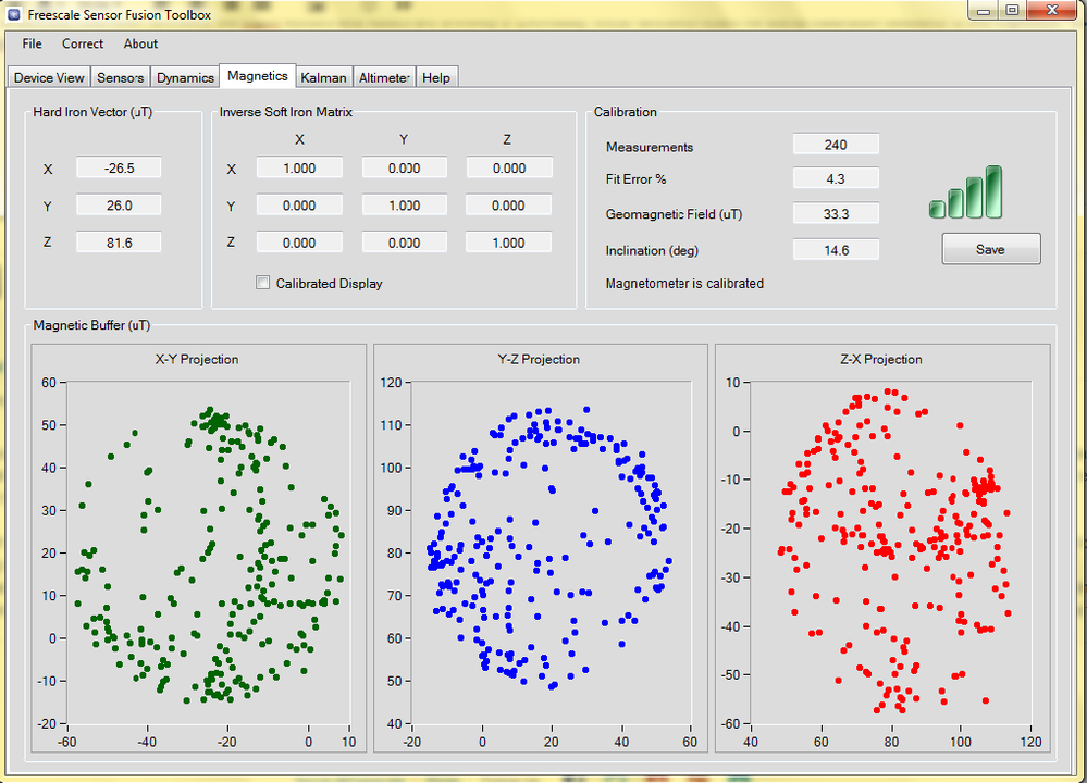

I'm not facing the issues while using KL25Z. Here's my screenshot:

Is the figure you included for KL25Z, or your board?
Generally we do rely on the fit error, but also look to make sure we like the look of the plots above ("Calibrated" displays should be circular).

I'm assuming the plots you have above are for your KL25Z running the canned project, as they look fairly reasonable.  I would really like to suggest that you do your debugging of this issue on that platform so you can immediately see the effects of your changes on the code.  Start with the working (continuously calibrated) project.  Confirm you get OK results, and then start making incremental changes & confirmation of results at each step.

Yes, that figure was for KL25Z. I'm using both magCal and eCompass.
