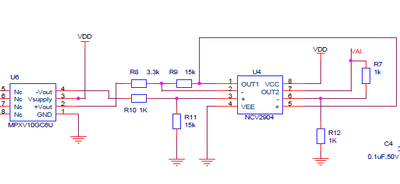

HI,  i am using MPXV10GC6U sensor for my application vaccume pressure is the input , at 1inch of the pressure the sensor shows different output at every time , how to tackle this ????
thank you in
 this is the interface i have used please guide me
advance

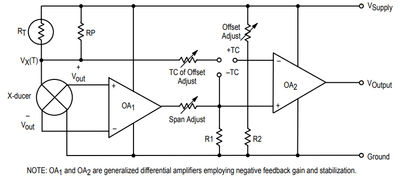

diazmarin09
Hello kumod,
I am pleased to contact you again.
I recommend considering the following circuit for the signal conditioning. Such a circuit incorporates both span and offset temperature compensation.
I hope this information will be useful for you.
David

kumod
Thank you for your message and the valuable information,
i have tested for for resistor method both series and parallel
1. for series method sensor works automatically showing false reading going 1 to 10kpa at no vacuum.
2.for parallel method not sensing observed no change in output at all at 0 to 10kpa no sensing .
