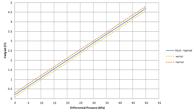

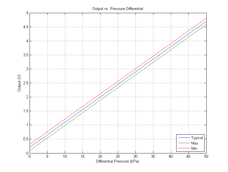

I have modelled the sensor characteristics in Matlab using the given transfer function:

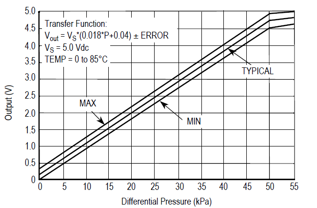

My plot does not match the datasheet plot for the Min/Max values:
I am using the transfer function given:
I'm unsure at this moment whether I am incorrect or the datasheet is. Can anyone confirm?
Thanks.

Hi Matthew,
Your calculation is correct, I have already asked the responsible team for correction. Sorry for any inconvenience this may caused.
Tomas
