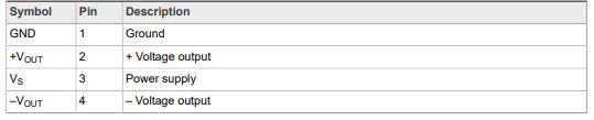

I am using the MPX2010GP pressure sensor to measure drop in pressure from airflow across sports fabrics. We expect a pressure drop of around 100Pa. There is currently an issue with the analog voltage output from the Pin 2 of the sensor.
The datasheet says that at max rated gauge pressure of 10kPa the voltage output should be 25mV, but when measured using an RS PRO digital multi-meter I get a value of ~2.8V. The bench power supply used to provide the 10V to Pin 3 of the sensor is from TTI EL302 PSU 0-30V,2A. I have repeated this with another MPX2010GP to check the original is not faulty. Everything is connected using a breadboard and jumper wires for prototyping.
Please could someone let me know what the potential issue with sensor or set up is here.
Pin connections are:
Pin 1: (Power supply) GND
Pin 2: Multi-meter
Pin 3: +10V
Pin 4: GND

Hi Sean,
It seems you are measuring the voltage on +Vout (pin 2) with respect to GND.
However, this is not correct, you should measure the differential voltage between +Vout (pin 2) and -Vout (pin 4).
BR, Tomas

Hi Tomas,
For the MPX2010GP it is a single gauge pressure sensor that I am looking to measure the pressure at a specific point, in this case where would the Pin 4 connect to as it is not a differential output.
