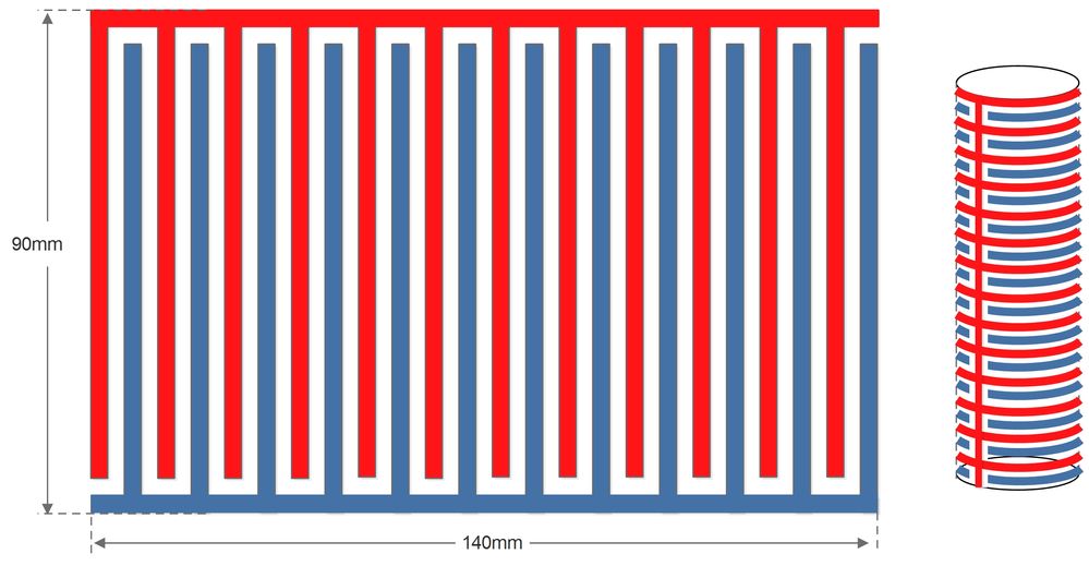

Hi, we are using the MPR121 for detecting the hand position on a bar (tube). hands may be positioned on the electrodes for a long time, 6 different areas must be distinguished,
everything seems to work correctly, but after some time electrodes randomly get stuck in detection state, resetting the sensors brings everything back to initial state.
vdd is 3v3
the tube has a diameter of about 3cm, and a perimeter of abour 9cm , we have 6 interdigitated copper electrodes with a shape like shown in the picture.
capacitive electrode is interdigitated with a grounded electrode to minimize proximity sensing and only detect touch. 3mm traces with a separation of 3mm.
The electrodes are covered with 1mm thick leather. total sensing area is about 125cm2, actual area of the electrode is about 33cm2.
configuration is based on AN3994. we disabled baseline filtering:

do you have any idea about why can it be that the electrodes get stuck in detection state?

Hola Enrique,
Electrode design and MPR121 configuration seems to be correct.
Seems like the steering wheel is changing the value of the baseline which is used as the reference for a touch condition, my recommendation would be to change the threshold to an upper value until you find the correct configuration to properly detect the touch.
