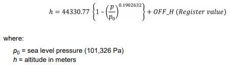

I took the device specs for understanding the calculations as these are given numbers:
Minimum: -698m
Maximum: 11775m
Minimum calculation with negative sign removed is 698 then you have to calculate the 2's complement backwards:
698 * 65536 = 0x02BA0000 - 1 = 02B9 FFFF != FD46 0000
Therefore, the left-most byte is FD which, based on AN4519 page 9 section 5.1 Converting a 20-bit Altitude reading to a signed decimal number:
The sign of the result is easy to determine by simply checking if the high byte of the value is greater than
0x7F. If so, then the value is a negative number and needs to be transformed by performing a 2’s
complement conversion. This involves executing a 1’s complement (i.e., switch all 1’s to 0’s and all 0’s to
1’s) and followed by adding 1 to the result.
So if the sensor was to output the following values:
MSB: 0xFD
CSB: 0x46
LSB: 0x00
Then this is the first step: Value = MSB << 24 | CSB << 16 | LSB << 8;
Second step is to evaluate MSB:
if( MSB > 0x7F )
   Altitude = (!MSB + 1)/65536;
Therefore, !FD460000 = 0x02B9FFFF + 1 = 0x02BA0000 / 65536 = 698 and because the MSB value indicates this is a negative altitude (> 0x7F), then add '-' to the value.
Maximum: 11775 * 65536 = 2DFF 0000

Hello Ben,
Yes, I think you properly understood it.
Note that the calculated altitude is negative if the measured pressure is higher than 1013.26 hPa, which is the default pressure reference at sea level stored in the BAR_IN_MSB (0x14) and BAR_IN_LSB (0x15) registers.
To convert the raw 20-bit data to a signed decimal number in meters, you need to first check if the number is negative or positive by looking at the sign bit (MSB of OUT_P_MSB). If it is positive, simply convert it to decimal. If it is negative, perform a 2’s complement to decimal conversion.
Example 1:
MSB: 0xFF
CSB: 0xFF
LSB: 0xF0
16-bit integer component = 0xFFFF = 0b1111 1111 1111 1111
1’s complement (inverting the bits) = 0x0000 = 0b0000 0000 0000 0000
Adding one = 0x0001 = 0b0000 0000 0000 0001 = 1
Since the original number was negative (MSB of OUT_P_MSB = 1), the final 16-bit integer component = -1
4-bit fractional component remains unchanged = 0x0F = 0.9375
The final decimal number in meters is -1 + 0.9375 = -0.0625m
Example 2:
MSB: 0xFD
CSB: 0x46
LSB: 0x00
16-bit integer component = 0xFD46 = 0b1111 1101 0100 0110
1’s complement (inverting the bits) = 0x02B9 = 0b0000 0010 1011 1001
Adding one = 0x02BA = 0b0000 0010 1011 1010 = 698
Since the original number was negative (MSB of OUT_P_MSB = 1), the final 16-bit integer component = - 698
Since the 4-bit fractional component is 0, the final decimal number in meters is - 698 as you correctly calculated.
If you are interested in relative measurements (difference in altitude) and not the absolute ones, the MPL3115A2 is a very good candidate for your application. It is intended more for the scenario of going between two floors or from one point to another and measuring this delta, than to be giving exact absolute altitude.
Tomas

To convert raw values to meters in altimeter mode I use something like this:
Altitude = (float) ((short) ((OUT_P_MSB <<  8  | OUT_P_CSB)) + (float) (OUT_P_LSB >> 4) * 0.0625;
As I mentioned earlier, the MPL3115A2 computes altitude as a function of pressure and temperature using the NASA Standard Atmospheric Model of 1976 as shown in the datasheet, section 9.1.3 and below.
BAR_IN_MSB, BAR_IN_LSB registers allow to modify the default pressure value (101,326 Pa) that internally is used in this equation:
Tomas
