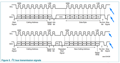

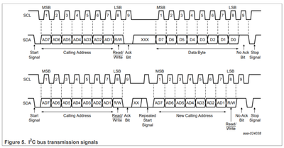

according to the datasheet Figure 5. before the stop bit the MPL3115A requires an NACK bit.
But if you are using the same code as before and it was working, the possibility is that the bus load is too high for the MPL3115A. Could you please test to remove all the devices except the MCU and the MPL3115A and test it, if the MPL3115A releases the bus after the stop bit. We have an AN4481 Sensor I2C Setup and FAQ, with some example codes. Please find it attached.

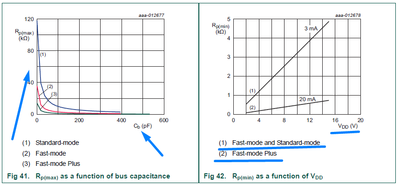

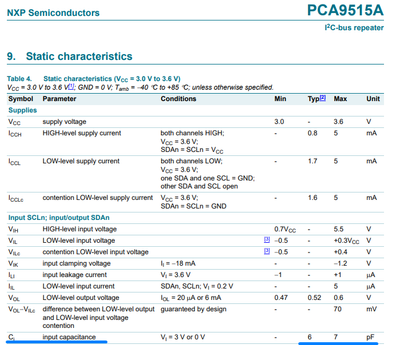

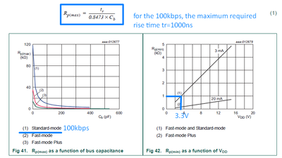

I would recommend you to increase the parallel resistance of the I2C on the MPL3115A2 to at least 3kOhm each. For the communication speed of 100kbps and for the worse case of 400pF bus capacitance, I have calculated the pull-ups Rp(max)=tr/(0.8473*Cb=1000ns/(0.8473*400pF)=2.95kOhm, but the estimated bus capacitance should be much lower. The MPL3115A2 Cb=20pF + PCB trace Cb and the PCA9515A Cb=6pF typically + PCB trace Cb. I presume you have not enabled the other devices when communicating with the MPL3115A2 (I2C lines of the other devices should be in high-impedance state?).
So for an estimated bus capacitance Cb=100pF, I have calculated  Rp(max)=tr/(0.8473*Cb=1000ns/(0.8473*100pF)=11.8kOhm.
Please also check the other parallel pull-up resistances and please check how many devices are connected to the I2C lines when communicating with the MPL3115A2

Is there a minimum loading requirement for the PCA9515A?
[A] No, there isn't. Lower the load, the better. There is higher pull-up resistors reserve. The Rp(min) is not depended on the bus capacitance and with lower bus capacitance Rp(max) can be higher.

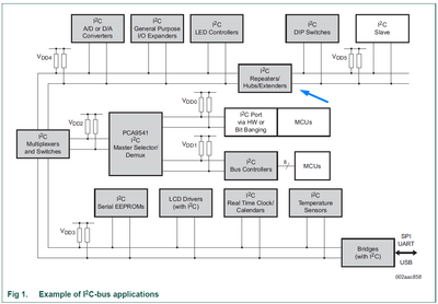

I would like to check the pull-up resistors on the SDA and SCL lines. Could you please share your schematic? What is the communication speed? Is it possible to find out a capacitance load of the each device on the bus? It should be in each datasheet. Could you please roughly measure the PCB traces lengths or cable lengths? I would like to estimate the bus capacity. Possibly you will need to use an I2C repeater.
