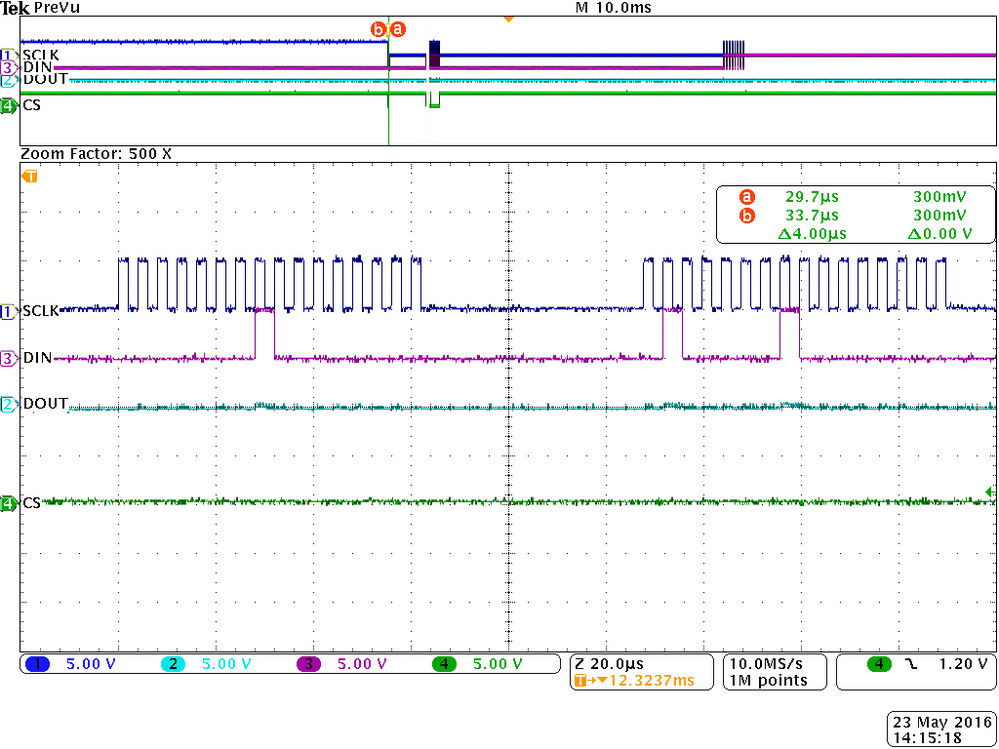

I have attached screen shot of SCLK, CS, DOUT and DIN lines
Surprisingly I can't see any data on DOUT.
Also, I have tried to disconnect DOUT from rest of ckt and probed on  MPL115A1 Pin 6. Though I can't see any data coming out. I have tried another IC incase first one is not working!! No improvement.

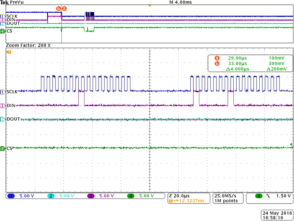

Not adding all Screen shots.

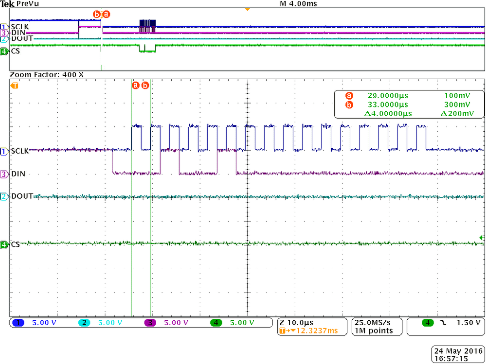

TomasVaverka
Hi Dhaval,
I assume the problem is in the base value of the clock (SCLK). The MPL115A1 uses the ‘Mode 0′ SPI protocol, which means that an inactive state of clock signal should be low and not high. If you use a hardware SPI, it corresponds to CPOL = 0 setting.

Thanks for reply. I have tried mode 0 but no luck. (not adding all screen shot here)

TomasVaverka
Hi Dhaval,

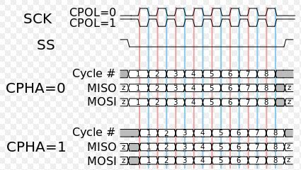

Looking at your screenshots, the clock signal is now correct, but the data are captured on the falling edge which is incorrect. Make sure that the data are captured on the leading edge of clock signal and changed on the falling edge (Mode 0 – CPOL = 0 and CPHA = 0).
