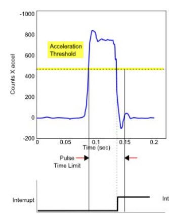

Hi, I am using MMA8652 in my project which also have Audio/Speaker. The speaker's vibration is affecting the data of the 3D accelerometer. At some point the vibration is considered as a TAP. Do you have any recommendation on how to mount MMA8652 or the speaker to avoid affecting my data. Thanks!

In this case I recommend moving the pulse threshold value in order to avoid the undesired TAPs.
In order to change the threshold value, you may refer to the PULSE_THSX/Y/Z register.
In order to get detailed information about the TAP detection, you may refer to the Application Note AN3919​.
Beside, you may find sample code here.
I hope this information will be useful for you.
If I misunderstood your question, feel free to let me know.  I will be glad to help.
