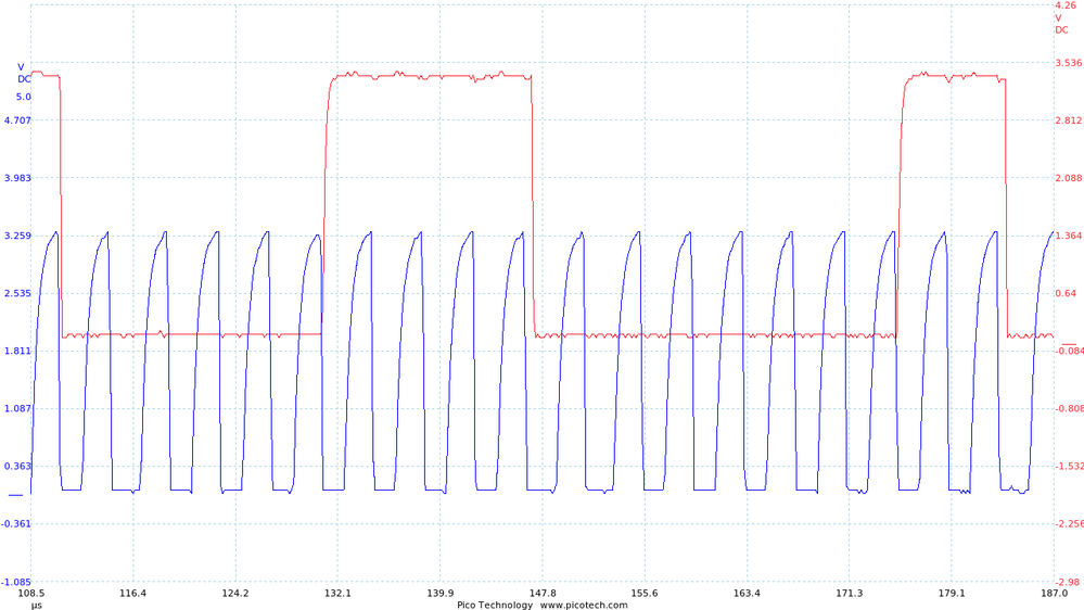

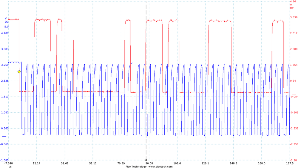

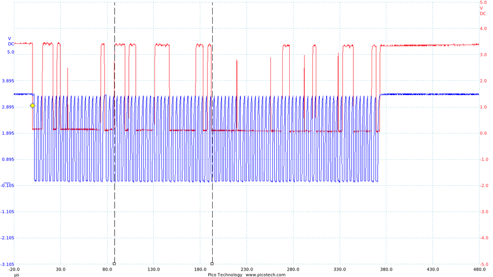

Okay, I switched to my backup board, here's the trace of reading 7 registers starting at adr 0 from the MMA8652
https://dl.dropboxusercontent.com/u/2651504/whole.png
And here's zoom'ed a bit more
https://dl.dropboxusercontent.com/u/2651504/zoom.png
If I need to zoom somewhere else let me know.
Best regards Morten

I have now tried to work with all my I2C devices, and I get strange values from all of them.
I have tried to lower my bitrate on the bus - I'm now running 250kHz
Here is a trace of the whole of a 7 byte read from adr 0 and up
Here I've zoomed in on the first part of the transfer
And here's further zoomed on the last bit of the zoom above
