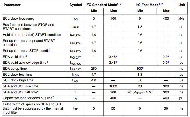

masahirokiniwa
Does MMA8452Q support I2C normal mode?
Its data sheet is written "its I2C is compatible with fast mode and normal mode" in P.16.
But its characteristics (P.8 Table 4) is written only fast mode specifications.

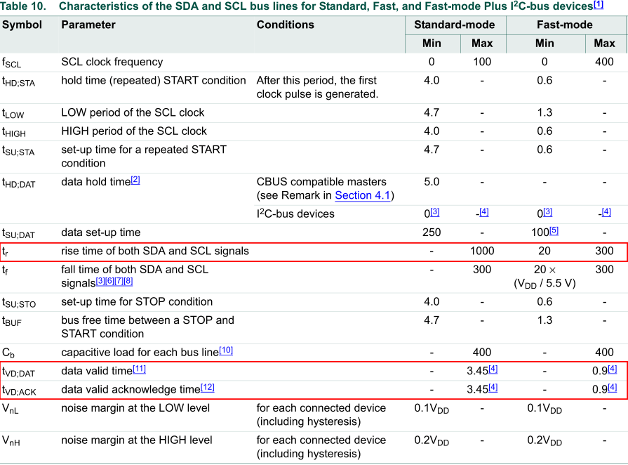

I care tr and tVD specifications.(below red square values in I2C specification Rev.5 P.48)
M.Kiniwa
1,488 Views
TomasVaverka
Hello Masahiro,
Yes, the MMA8452Q is compliant with NXP I²C specification for both Standard and Fast Modes:
Tomas
