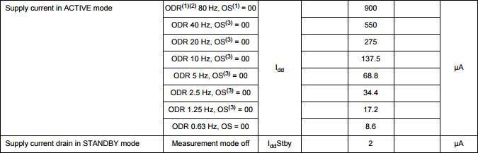

How are you measuring this current consumption? Are not there other devices drawing current as well? Could you share your schematic?
Also be aware that the current consumption stated in the datasheet applies for VDD=2.4V and has been measured with an amperemeter between 2.4V voltage rail and VDD input only.

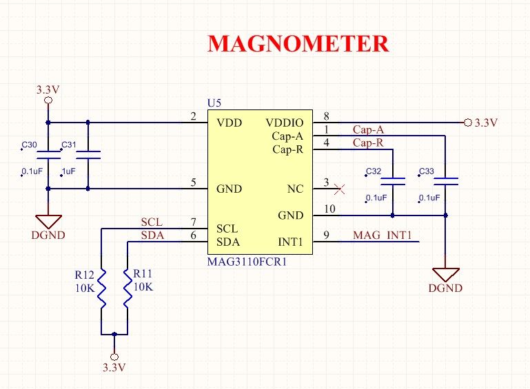

Thx Tomas,
here the schematic:
As you can see there's nothing "strange". 99% sure that the power consumption is due the sensor since when I place the microcontroller in sleep without init the sensor the board draws around 1mA and when I place it in sleep whith the sensor initializated the current draw is around 11ma. On any case my configuration is ODR = 10hz OSR = 128 and according to the datasheet current draw should be 900uA.... :-(. And as I said before the real problem is that I can't place the sensor in sleep mode so I guess there's something wrong in the initialization. If I init in trigger mode the power comsumption is the expected but I always get the same x,y,z measurements.... :-(

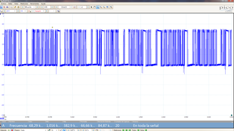

SDA and SCL seem to work right. Here SDA:

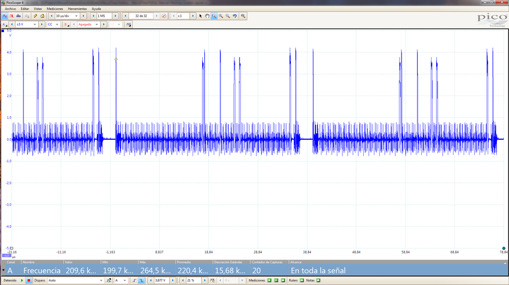

Well not so usual since I2C is sending a lot of data and the reason is in INT1:
As you can see, besides that is a noisy signal, the interruption is being triggered with an irrational frequency: 200Khz!. It should  be 10hz according with the registers. When I place the uC in sleep SDA/SCL go high but even when I can read the AC bit as '0' (standby) time before the sleep, INT1 continues being triggered.
Same behaviour with Mag_RST & AUTO_MRST_EN disabled.
