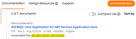

For resources on SPI communication, please refer to:
- The app note below on the NBP webpage (https://www.nxp.com/products/NBP8-9x). It has an associated file which is an excel tool to encode and decode SPI commands and responses.
- The user guide of the KE15Z Host application for NBP8, which includes screenshots of SPI communication. The user guide can be found in below package:
https://www.nxp.com/webapp/Download?colCode=NBP8x_Application&appType=license
