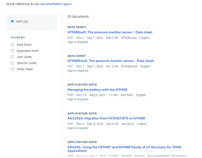

JozefKozon
Hello Nikita,
the reason could be input saturation. Please refer to section  in AN4391. There is description of the fault and in section 4.2 is NXP recommendations how to solve it. The AN4391 can be downloaded from the NTM88 product page. There is lot of other documents to the NTM88 TPMS, which might interest you.
With Best Regards,
Jozef
