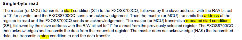

As written in the FXOS8700 datasheet I²C communication has to follow these rules:

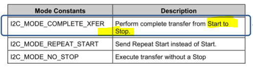

Unfortunalty,you're using the I2C_MODE_COMPLETE_XFER which adds a stop condition at the end of the write operation...
You probably need to use I2C_MODE_NO_STOP for the first transfert (read operation). Should be a thing like that:

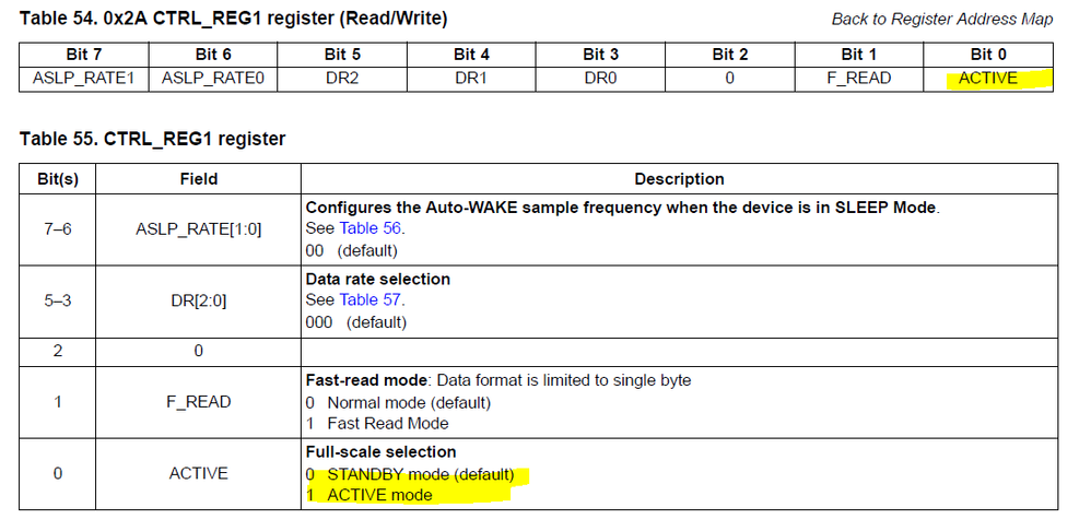

There is no specific order to configure the device. You have just to begin by putting the MMA in Standymode first, then configure all your registers and finish by switching it in Active Mode. In fact, register changes are saved and effective when the MMA moves from Standby mode to Active mode.
StepNoteRegValue to write
1MMA8653FCR1 in standby modeCTRL_REG1 (0x2A) 0bXXXXXXX0
2Configure the device ....
3MMA8653FCR1 in active modeCTRL_REG1 (0x2A)0bXXXXXXX1
