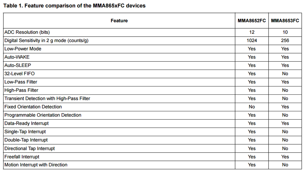

anthonyduhamel
Shalin,
There is no specific order to configure the device. You have just to begin by putting the MMA in Standymode first, then configure all your registers and finish by switching it in Active Mode. In fact, register changes are saved and effective when the MMA moves from Standby mode to Active mode.
StepNoteRegValue to write
1MMA8653FCR1 in standby modeCTRL_REG1 (0x2A) 0bXXXXXXX0
2Configure the device ....
3MMA8653FCR1 in active modeCTRL_REG1 (0x2A)0bXXXXXXX1
For motion interrupts on MMA8653, I have to check. I'm used to work with the MMA8652: motion detection can be easly enabled by using Transient Detection with High-Pass filter feature. Unfortunalty, MMA8653 doesn't get this fonction, so I will see if it's possible.
I will take a look at Motion Interrupt MMA8653 feature. If you progress on your side, keep me informed.
Anthony

anthonyduhamel
Hi Shalin,
You have to make sure the I²C communication is working well. I suggest you to read the WHO_AM_I register (0x0D) which contains the Device ID (0x5A). If you don't read 0x5A, maybe you have a problem with I²C com (can be missed pull-up resistor, invalid frequency) or with the MMA . If you read the right value, it could be a configuration problem.
Let-me know if you're able to communicate with the MMA reading the Device ID. After ensuring that, next step is to check your motion detection configuration.
Anthony
